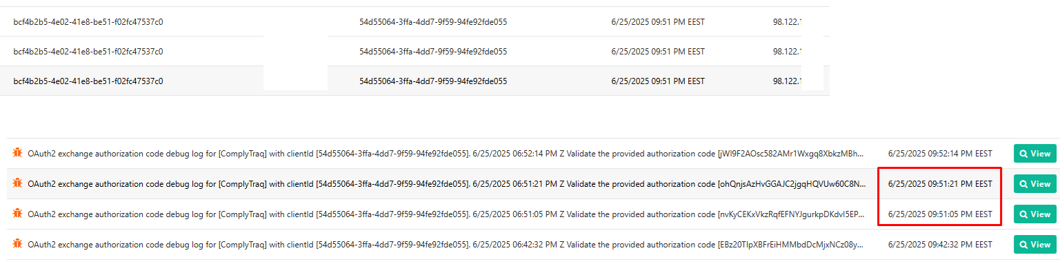

        Also we have 3 login records and only 2 corresponding entries (for the same minute) in event logs:

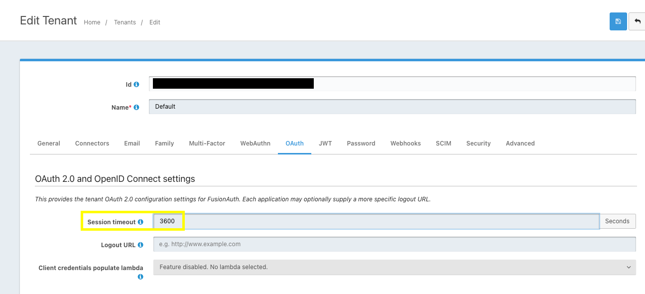

            There is a setting in the Tenants for the Session timeout.
            Tenants -> Edit -> OAuth tab -> Session timeout
            Let me know if you are able to log the users page views.

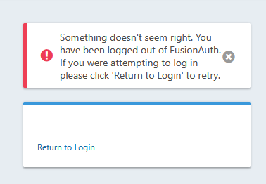

                Sometimes user sees this:
